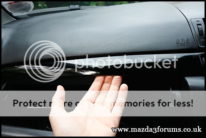

1:  Open the glovebox and locate a dip under the glossy trim.  Put your fingers under and gently peel away.  The trim will pop off - work your way down to the steering wheel.  The last clip is tricky but simply gently yet firmly pull away and it will come.

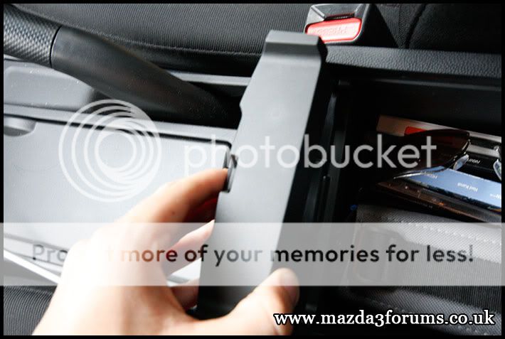

3:  Lift where you see my fingers then pull up and back to remover the plastic gearshift surround.

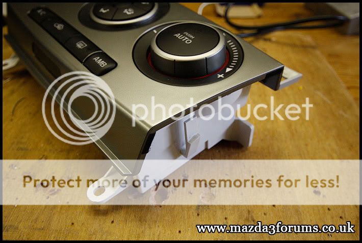

6:  Undo the two screws under the aircon controls to remove it.  You also need to put your hand in the dash and press the clip connectors on the sides (shown below) to release this part.
Thats it!  You should have all the parts removed now and ready to install a short shifter or ipod radio cable!
