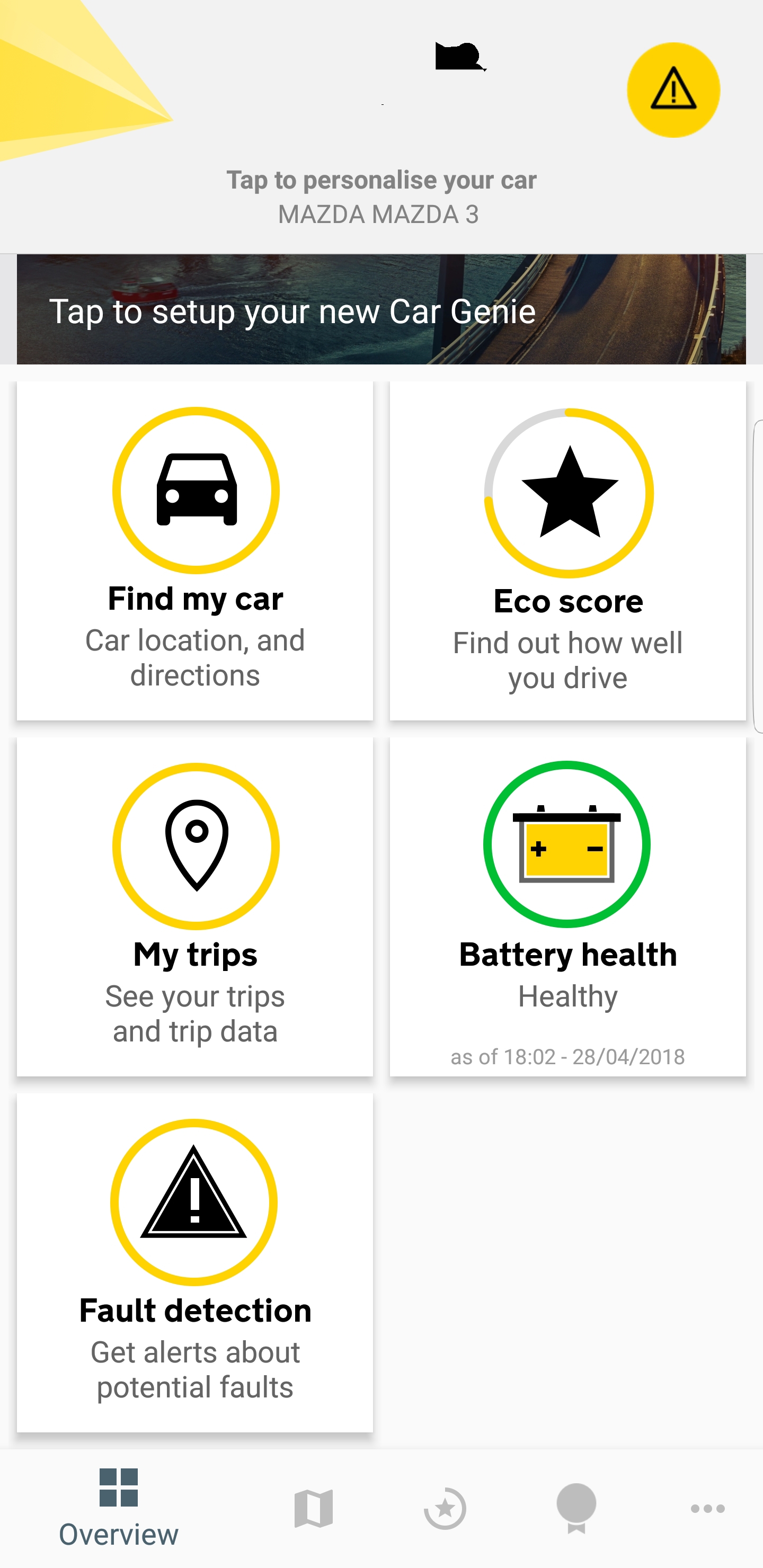

So we now have one of these...
I wasn't seduced by the singing baby...even though the ad uses a gen 2.
However means I now have this on my phone..
Find my car should come in handy if it gets nicked as should the battery monitor. Hopefully I'll continue having no faults to be diagnosed.
Will say I'm not paying any money for this...it's free from work.

Battery is possibly on its last legs now, holds charge ok but in cold weather after 2 days car genie is pinging low voltage warnings at my phone.
It's ok as long as it doesn't have a lay up, couple of days without moving and the voltage drops off. It's the OEM battery and over 7 years old so not massively unexpected.

If I didn't have the Car Genie I probably wouldn't have noticed, at least until one day it got too far down and stranded me anyway. It's still starting ok at the moment though if we have a really cold night that might be it. Once I'm back to work it'll be used 5 days out of 7 again so unlikely to die on its backside.
