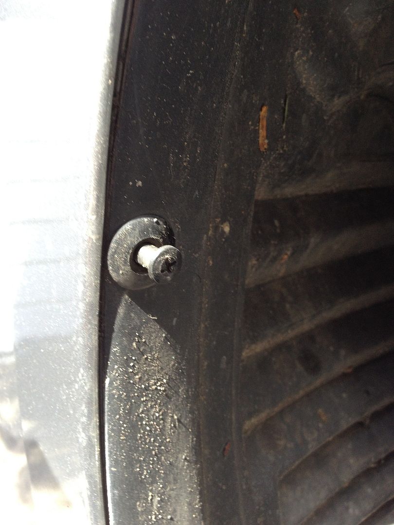

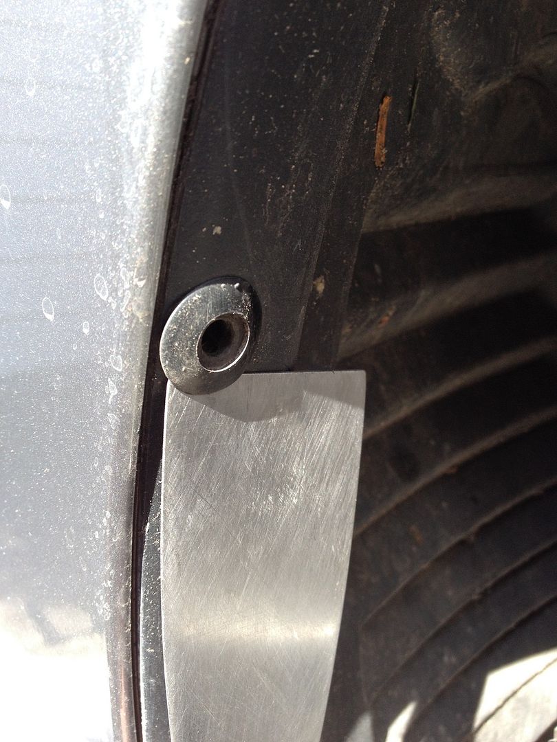

Remove these
There are 3 plastic screws & 3 plugs each side to be removed from the plasti wing liners.

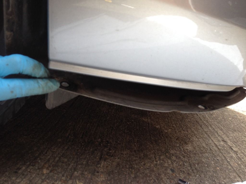

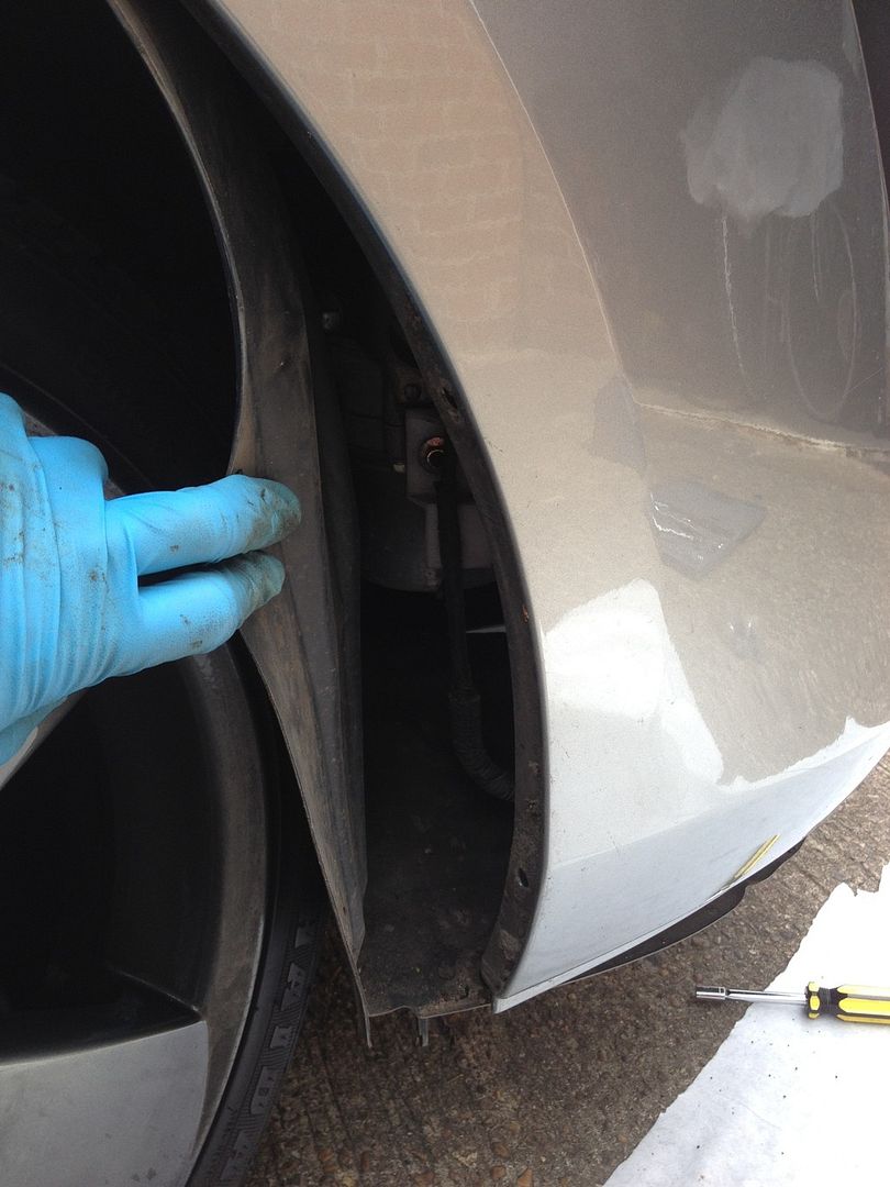

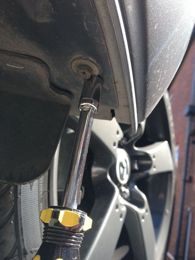

Then I removed the lower valance n/s & o/s bolts these sections you can then pull down to get to the fog lights
As above pictures show the panels can be just pulled back to gain access.
