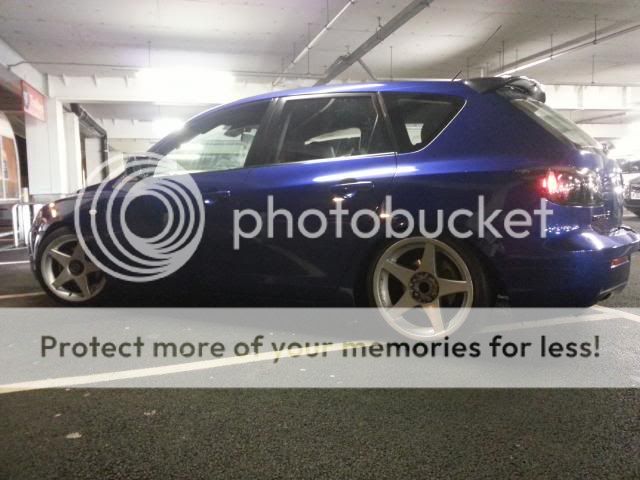

Any close up of rear fitment mate? I was thinking of going 17x9.75 et25 on rear but,think may poke too much even with a bit of tyre stretch? If not going to go 8.25 et30 all round
Offline Wash
  • Posts: 246
  • Colour: Aurora Blue (34J) Metallic
Re: Wash's Mazda 3 Project
« Reply #18 on: November 06, 2013, 12:35:13 PM »
I'll take some pictures later tonight. It depends how low you're going to go though, I've now lowered mine on coilovers and I've realised that I need spacers for the rears because they're not quite flush and I'd like them to poke out a bit more. If you're going pretty low then I'd say go for it but you will probably need something like a 215/45 tyre and might need to roll your arches. Mine are 9J ET35 with 205/40s on them but I have had to roll and pull my arches a little. They don't rub but they might occasionally tough the wheel arches when the suspension hits it's lowest point.

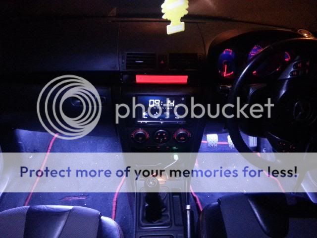

Also fitted some LED footwell ambient lighting, just a simple and clean white colour for the LEDs.

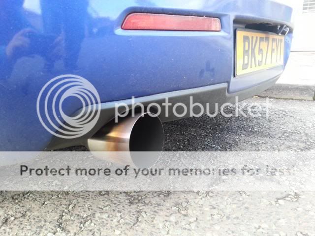

A new exhaust too! Sounds really good for a diesel but I haven't got any videos unfortunately. Might make one eventually.
