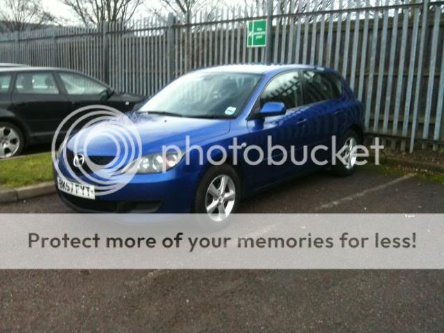

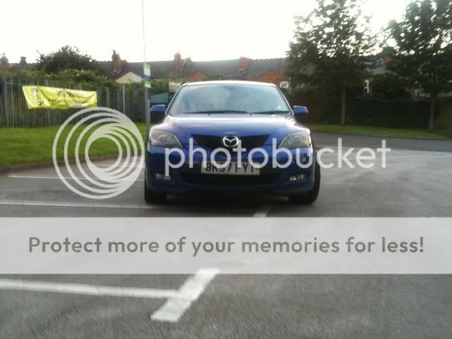

When I bought it, it looked like this... A bog standard Mazda 3 TS 1.6 diesel.

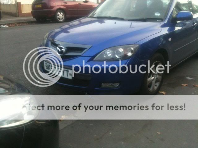

Finally managed to find the front grille that I needed! It needs painting, I know.

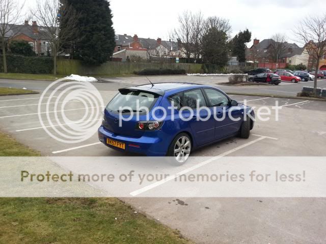

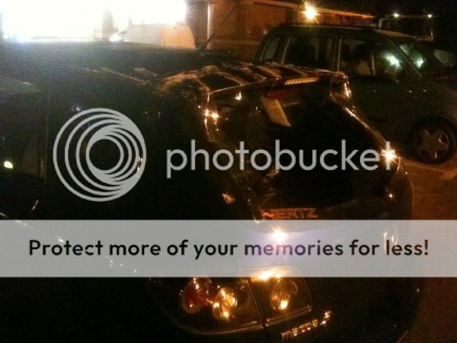

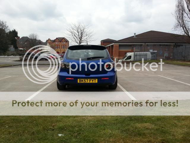

Next I added the sport rear spoiler, the Mazda 3 looks seriously ugly without a rear spoiler.   :-\ The spoiler was stuck on with tigerseal and it's held up very well, I could probably stand on the spoiler and the spoiler would break before it detached itself from the car.

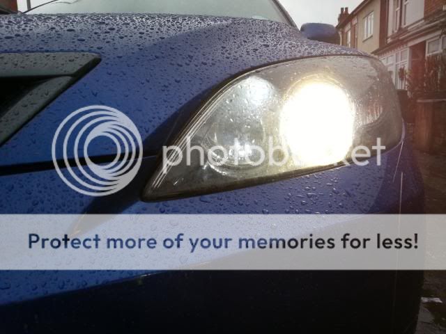

The standard headlight bulbs are appalling, I couldn't even tell whether they were on or not half the time so I bought a 4300K HID kit to replace the standard halogen bulbs. I also replaced the side lights for LED ones at the same time.

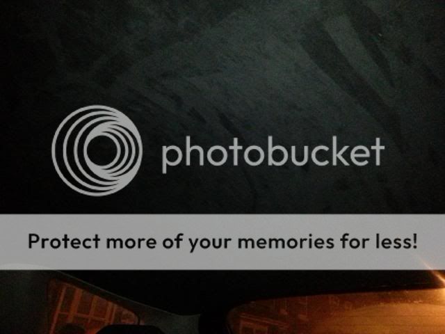

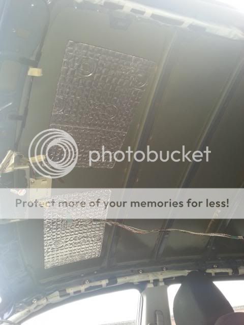

Covered the roof in a fake suede/alcantara fabric since I didn't really like the standard grey headlining on the Mazda 3. I used some spare sound deadening sheets I had left from deadening the doors on the roof.

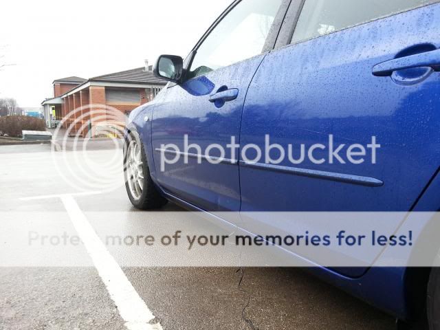

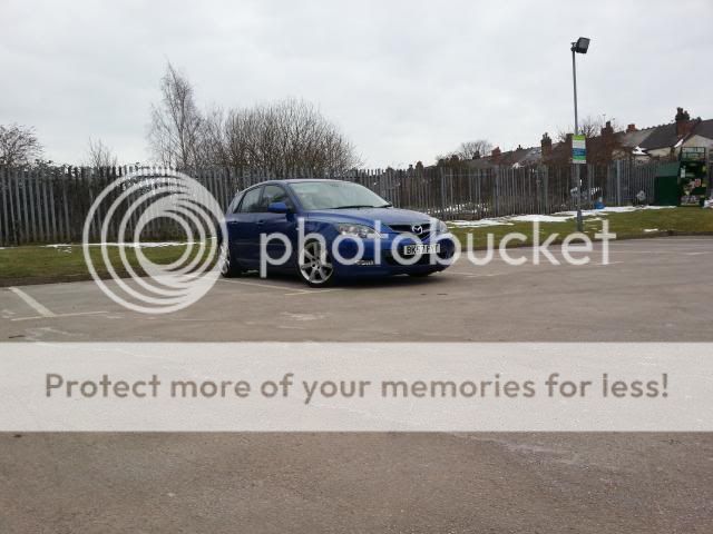

After that I had the car lowered on Apex lowering springs, handling has much improved with a lot more stability and much less body roll. Achieved a drop of about 45ish mm at the front and 35-40mm at the rear so the stance had much improved too, getting rid of a lot the standard arch gap. I had all the brake discs, pads and fluid changed at the same time for new Pagid items along with a new timing belt, timing belt tensioner, water pump, thermostat, coolant and aux belt.

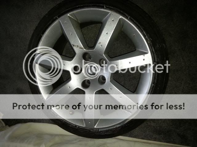

I've read in the US of a couple of people using 350z wheels as the centre bore is very similar (Mazda's is 67.1 whilst the 350z uses 66.1) so I bought a set. You need to use spacers (I used 3mm shims) on the rear just to get a bit more room to make up for the very slight difference between the centre bores.

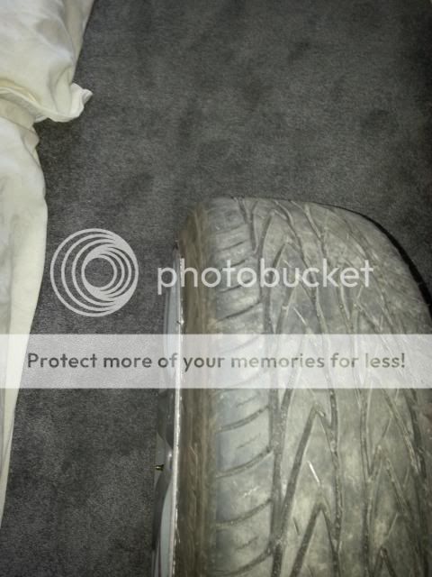

These wheels were 7.5J ET30 front and 8J ET33 (ET30 with 3mm spacers) rear. They came with 225/45/17s front and 245/45/17s on the rears which are way too wide for the Mazda 3's wheel arches but I test fitted one anyway just to see what the fitment was like.

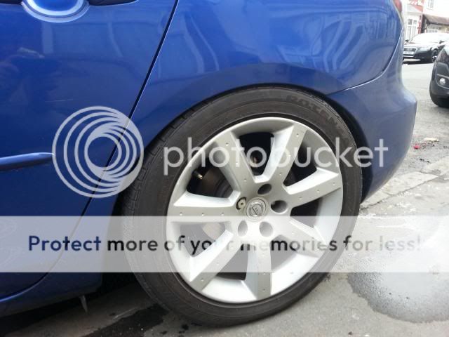

Same wheels with 195/45/17s on the front and 205/45/17s on the rear, giving a little bit of stretch.

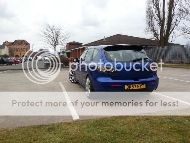

Here's a few pics of them on the car, I think they look great on the Mazda 3! At the same time I sprayed the rear badges black (I removed the TS badge a long time ago for a cleaner look) and put on some pressed number plates to replace my old tatty broken ones.

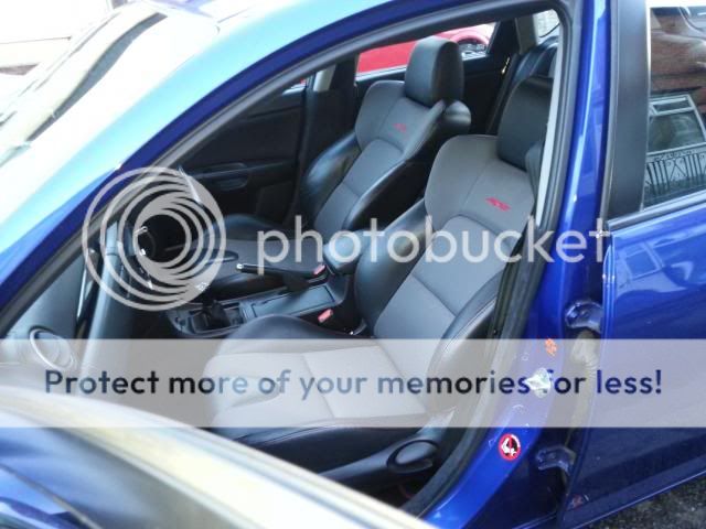

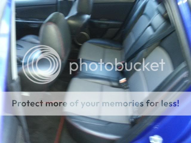

Sourced an MPS interior and wasted no time in fitting it. I changed the mats for MPS ones too but I did that ages ago, I never took any pictures of them though because I felt a little silly taking pictures of mats lol. The seats are so much better than the standard 3 seats, a lot more supportive and they look a lot nicer too! :D
