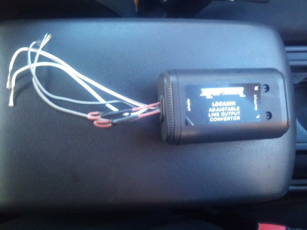

To start with your going to need a "Speaker line to RCA converter" a quick search of that on eBay shows 29 products ranging in price for £6.49 delivered to about £27. I spent just over £10 for my one however I ended up getting it from the local car shop. Regardless of which one they all look the same and do the same job.
As you notice mine has 6 wires coming out. Left Speaker +/- Right Speaker +/- and then two brown earth's. the brown earth's I've just doubled over and taped since they're just for changing the signal going through and weren't needed.

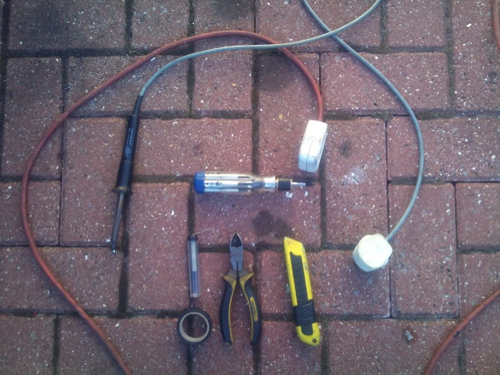

The tools I used were:
Snips.
Knife.
Insulation Tape.
Multifunction Screwdriver.
Soldering Iron with Solder.

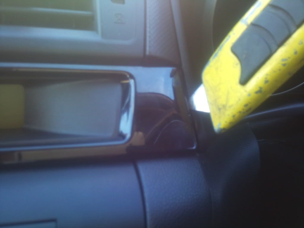

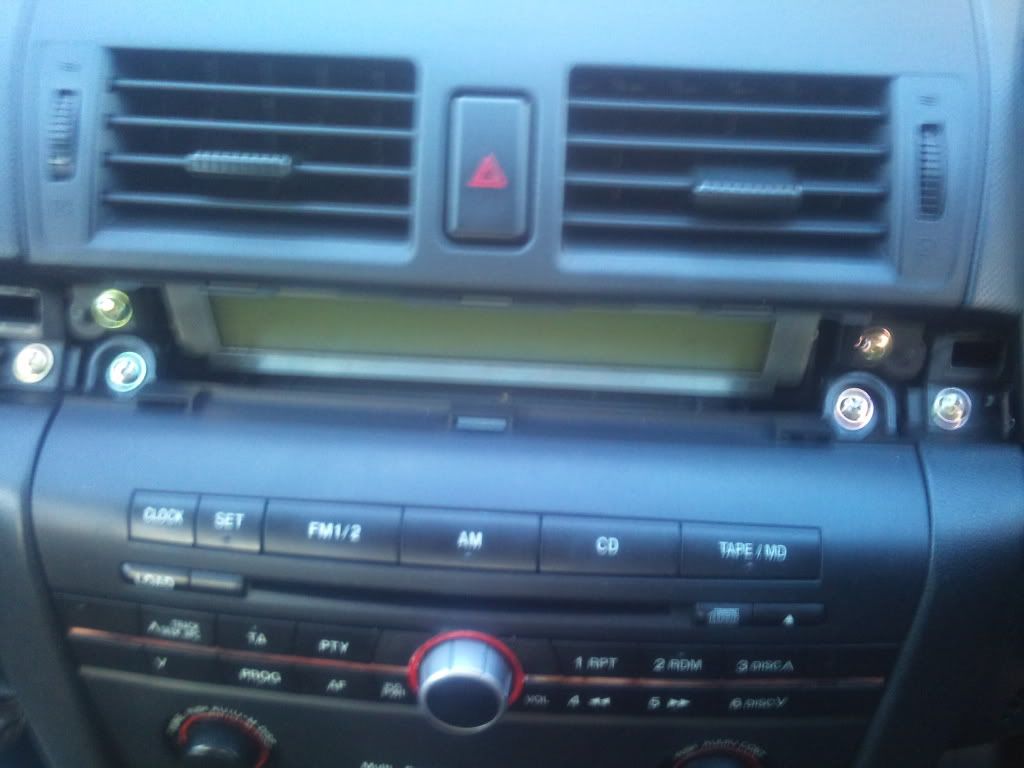

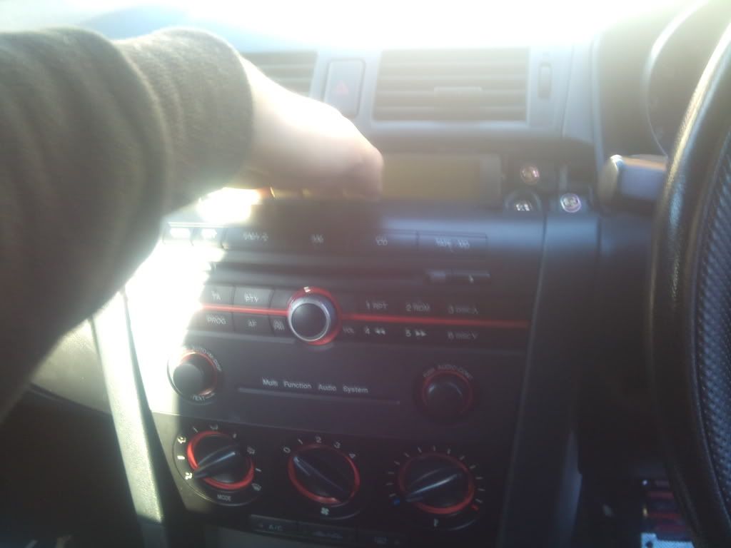

Right so the first thing your going to want to do is remove the trip which runs across the dash above the head-unit/glove-box. in order to do this I used the knife blade on the driver's side to lever the clip outwards, once that clip has released you can get your hand round the back. theres another two clips to get out then the whole panel slides to the right and comes straight off. This will then reveal Two nuts which hold the head-unit in place, with a Phillips (cross-head) on top of you can use a 10mm socket if you prefer.
Once you've removed the two screw and put them in a safe place grab the head unit by the gap at the top between your front panel and the LCD screen above as shown and pull the entire unit straight out. it will weight quite a bit but will slide straight out with very little trouble. to remove the aerial wire just pull straight out, and for the wiring harness there is a clip which you need to push in to release.

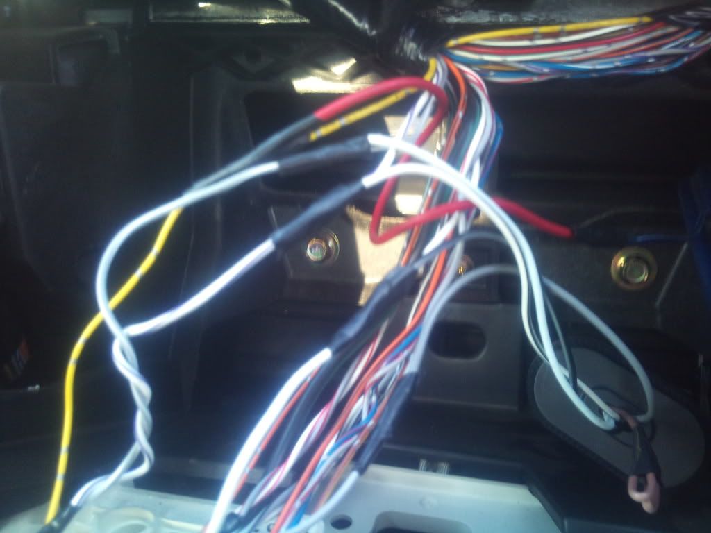

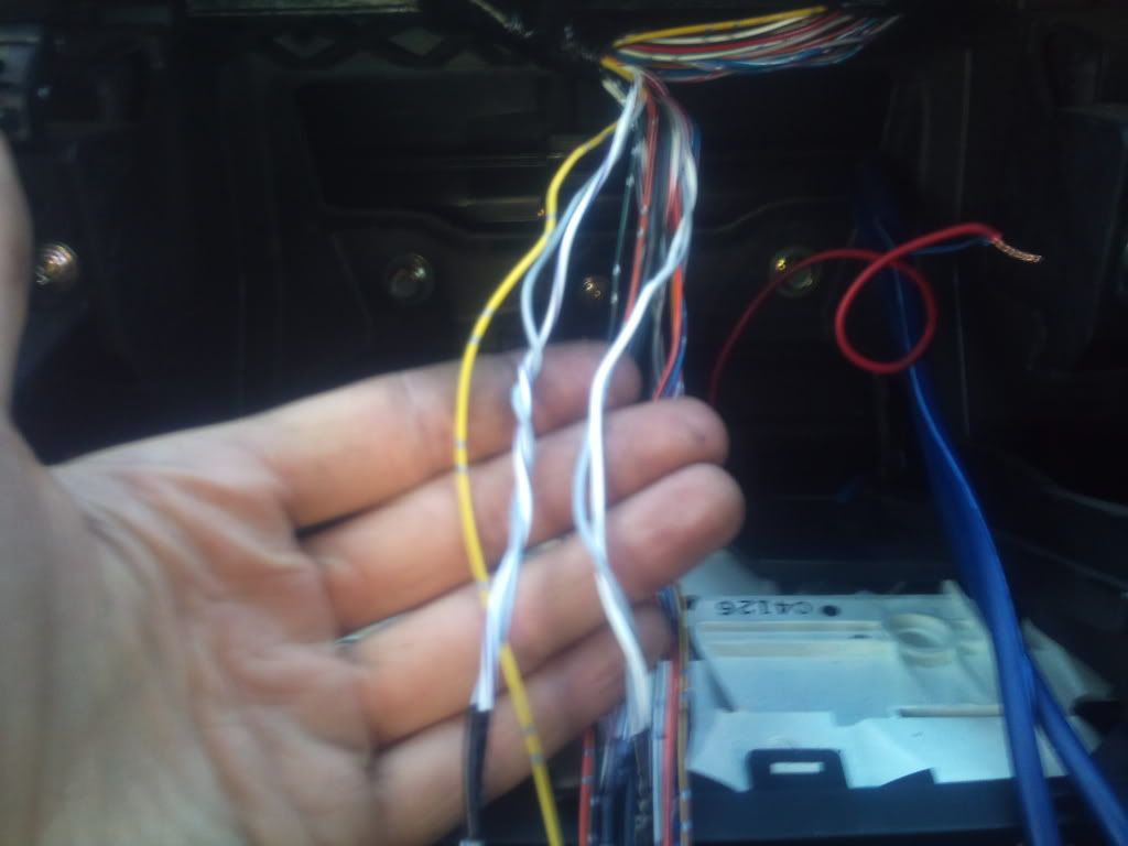

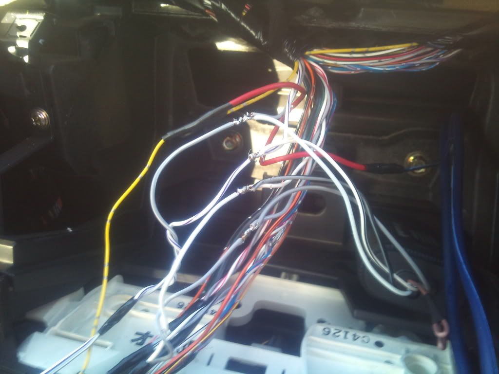

Once your head-unit is removed and your wiring harness is free, use your knife to cut away any of the plastic that may be covering your wires. Once you can see the wires there are 5 wires you want to concentrate on, in my car a 2004 Mazda 3 saloon, these are:
Yellow - Ignition live -for your amplifiers remote turn on wire.
Grey - Rear Left Speaker Negative
White - Rear Left Speaker Positive
Grey/white - Rear Right Speaker Negative
White/Purple Rear Right Speaker Positive
In order to bear the plastic from the wires i use my snips to carefully pull the plastic back a bit, however if your worried about cutting the wire completely i would recommend either using your knife to gently cut it back or using some Wire Crimps. Once you've revealed the copper wires on both the end of the wires from your Converter and the wires in your head-unit harness you need to wrap the wires from the converter around the harness wires to give a tight hold on each other. then using your soldering iron dab a bit of solder onto each of the connections to secure it. Finally cover all the connections with insulation tape ensuring that you haven't missing any coppers that could short out. Another way you can connect the wires is via Scotch-Locks instead of soldering. The joint wont be as secure and wont give as clear a signal but is an easy alternative if your abit novice with a soldering iron.

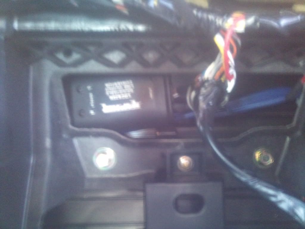

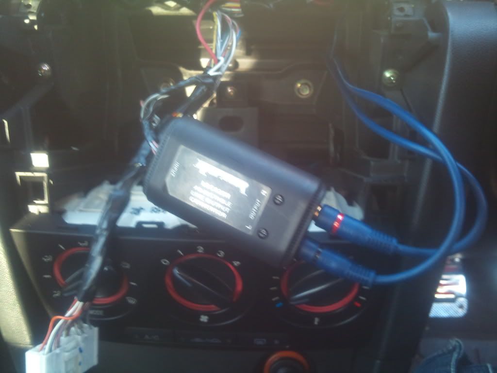

Once this is all insulated, tape around the entire harness from the plug to where you've made the connection, making a neat job so that the head-unit will fit back in again and find a place to hide your converter. On my car, there is a big hole right at the back of the open area which was the right size for me to slot my converter into as shown. Before pushing your converter away simply push the two RCA cables into the two terminals on the other side of the unit and push it out of the way so as not to obstruct the head-unit.
