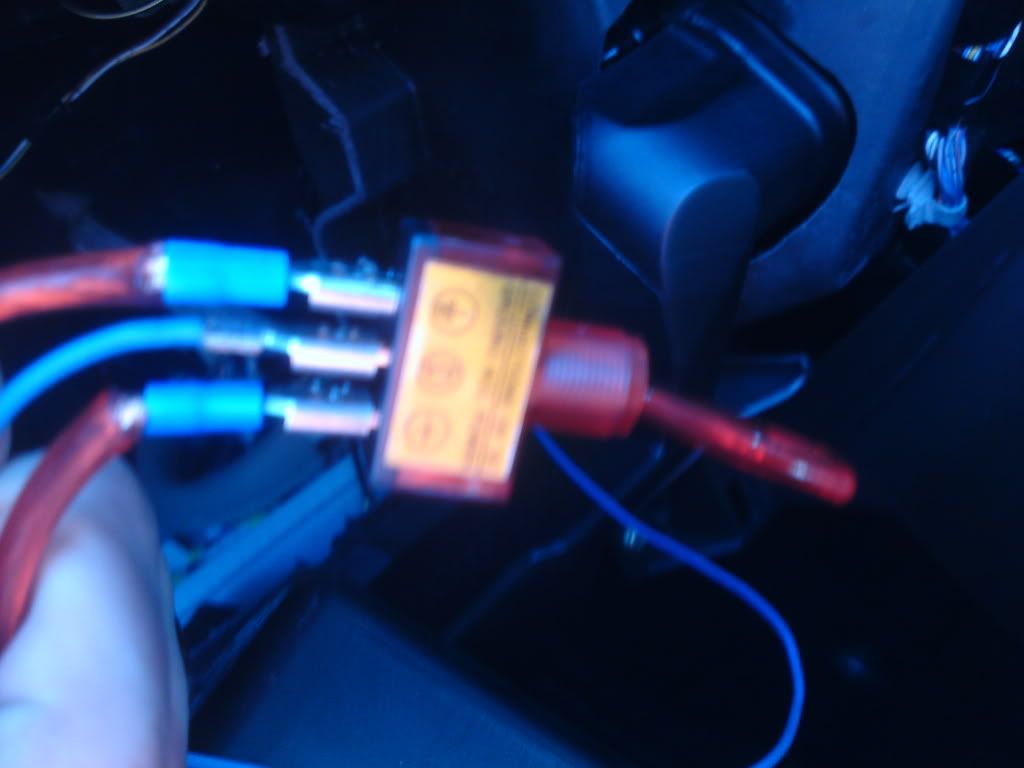

Heres a quick guide to installing a remote switch for a amplifier
You need the following
1 flat head screwdriver
1 phillips screwdriver
1 toggle switch
1 zip tie
couple of meters of power cable
and your remote cable for amp
I used a toggle switch from halfords http://www.halfords.com/webapp/wcs/stores/servlet/product_storeId_10001_catalogId_10151_productId_186525_langId_-1_categoryId_165562
This guide will show you how to install the switch in the glovebox by replacing the glovebox light
( Its a good idea if you dont want to be making holes in your dashboard )

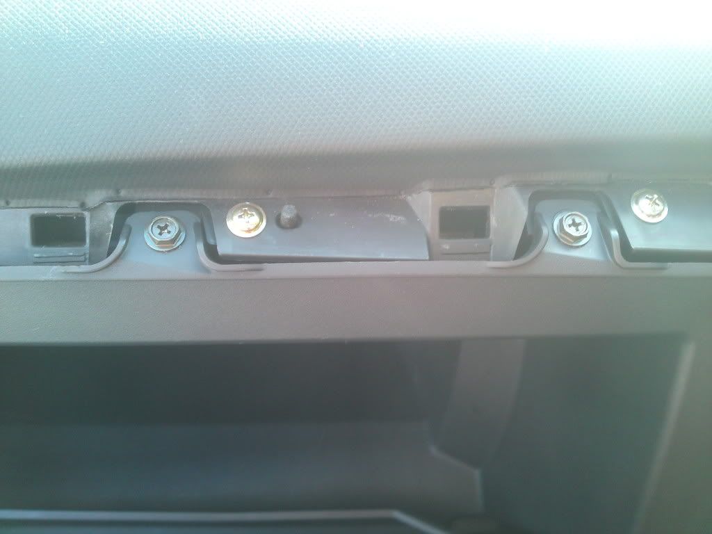

1* Remove the grey trim by gently prising the clips out behind the trim with a flat headed screwdriver
2* Remove the 2 black screws using the phillips screwdriver
3* Gently remove the glovebox by pulling the glovebox to remove the clips

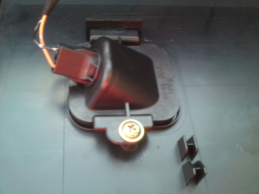

4*Unscrew the light and remove the plastic shade
5* Remove the light by pushing the clips holding it in
6* Secure the light and wiring somewhere out the way using a zip tie

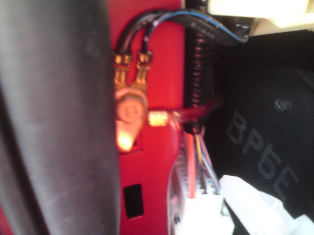

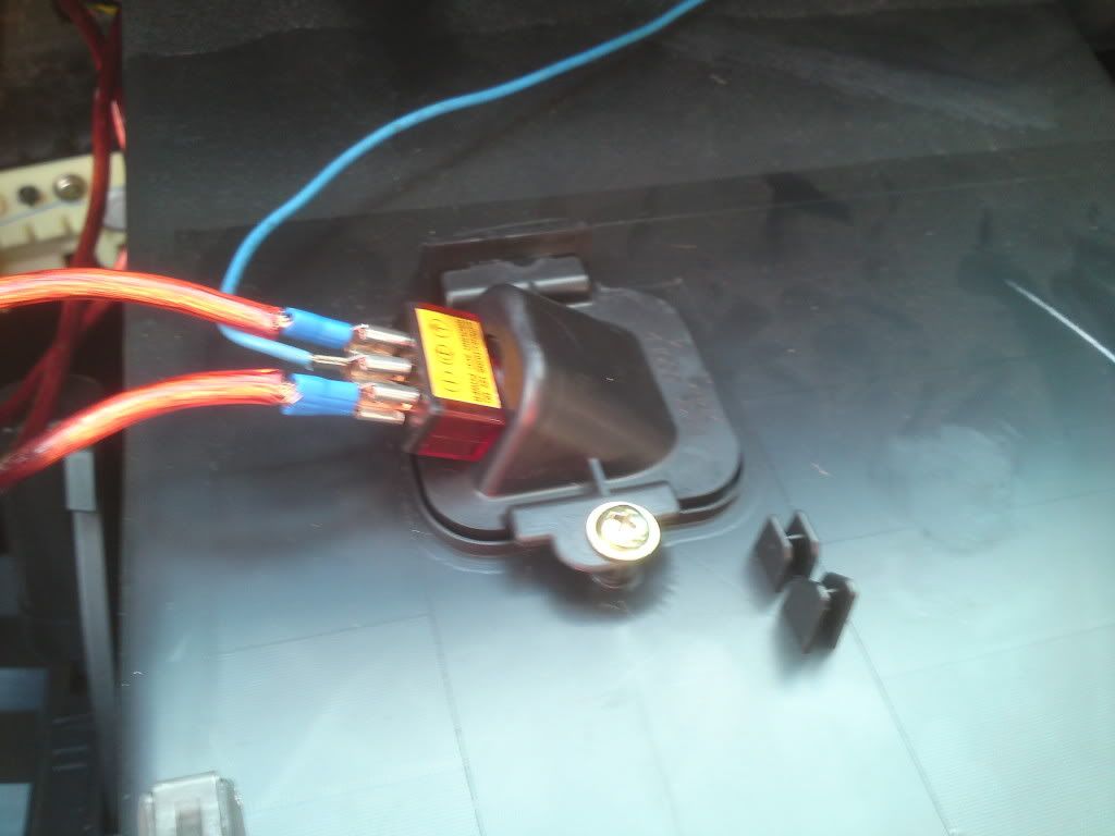

7* Wire up the switch ,power lead from battery,earth and remote cable from amp to switch, there is a good place to earth it just behind the plastic trim kick panel. also for the wire to battery there is a large grommet behind where the glovebox was you can pop it through there

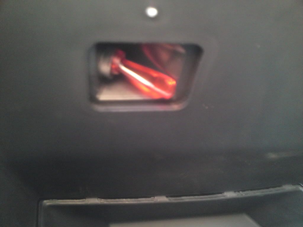

8* Unscrew the plastic nut off the switch and push it throught the plastic holder where the light used to be and screw the nut back on to hold it in place (make sure there room for the switch to operate)
9* Screw the holder back into place
10* Re-fit the glovebox by reversing steps 1-3 (be carefull with the wires when re-fitting)
Job done

Dude.  How come you have such massive cables going to your switch?  Are you switching the permanent live to the amp?  You should be really clear on how you wire up this thing.
Ideally what you want to do is wire your amp directly to the battery, and directly to ground.  Then you want a switch that connects the Amp Remote cable to the Ignition Sense cable (found on the Mazda headunit connector, tap this).  This way, when you take out the key, your amp turns off and your battery doesn't go flat!  Also, you shouldn't get a thump from your sub when you flick the switch on and off (if its a decent amp with an anti-thump circuit).
Also, please use insulated female spade connectors.
I have to agree with hussein.. plus the copper is exposed.. that can cause a risk should anything come into contact with it.
Ideally do what hussein suggested and just use the ignition to use as remote amp turn on.. :)

Be careful with the switch too, its rated at 16A which is likely to be less than the draw from your amp, so please change your wiring over asap before burning out the switch.  While you are there, make sure all of your new cables are fused to the correct level as close to the source as possible.
If you have any questions or comments about what we are talking about here (no matter how small or trivial), reply here and I'm sure we'll help you out.  DC electric shocks are no joke!

the amp is powered from battery and earth properly. the switch is just for the remote wire and the copper isnt showing as they have rubber covers which go over them (not shown in  pic)
where can find this wire to connect the remote onto?

On the back of the Mazda headunit
J is actually marked as 'Amp Remote' (Purple/Blue) but I think this is BOSE only, so who knows whether it would work.  I think you can safely ignore it really.  The important one is R, 'Ignition +12V Switched' (maybe Green/Orange, but could vary).  Tap this for your Amp Remote and your amp will turn off when you remove the key.  Convenient :)
