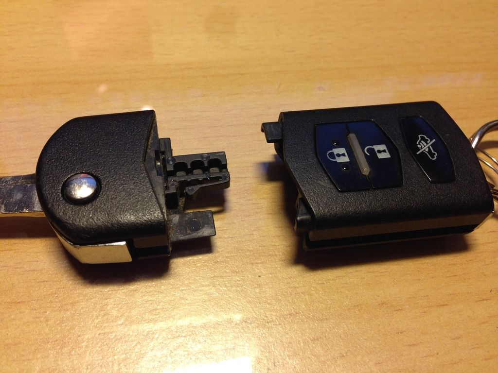

I thought I would post this just to clarify how you change the battery in the Mazda key fob, I have seen similar posts but none with a picture guide.
The correct battery you will need to perform this replacement is a: CR1620 battery.
Step 1: Flick out the key from the remote.
Step 2: Turn the fob on its side where the flip out key sits and you will see a small tab inside.
Step 3: Use a small flat head screwdriver and push down on the tab whilst pushing towards the top of the key.
Step 4: The top part of the remote will now release like so.
Step 5: On the opposite side to where you pushed down the tab, slide the screwdriver into the small gap and pull away the bottom half of the remote.
Step 6: The battery will now be revealed! Simply release the battery from its holding position and insert the new one.
Step 7: Now just re-assemble the remote by clipping the bottom half and top half of the remote together, followed by re-inserting the key part.
Hope this is helpful! :)

Hello Carl. I have just changed the batteries in the key fobs as well. Your pics are very good and informative. Can I mention one other point. Its worth removing the PCB and cleaning the rubber membrane and also the contact points on the PCB. Regards to all, keith h

Probably worth pointing out somewhere in this thread that there is more than one type of Mazda 3 key fob. No idea how many but mine is totally different from the pictures with a different battery.

Yep this thread covers the standard mk2 none keyless entry remote locking key.
