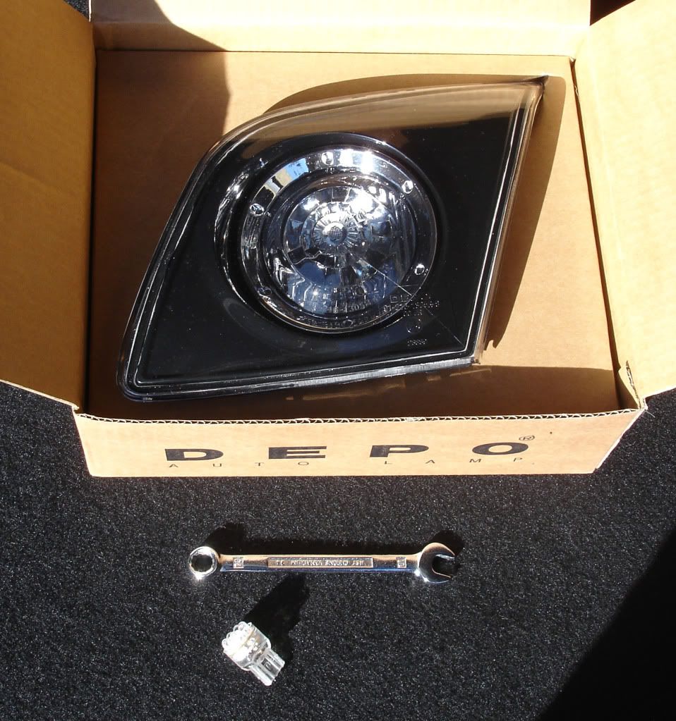

First off you will need the following:
One replacement lens
One size 10 spanner
One RED W21W / 7440 Wedge bulb. I went for an LED bulb.

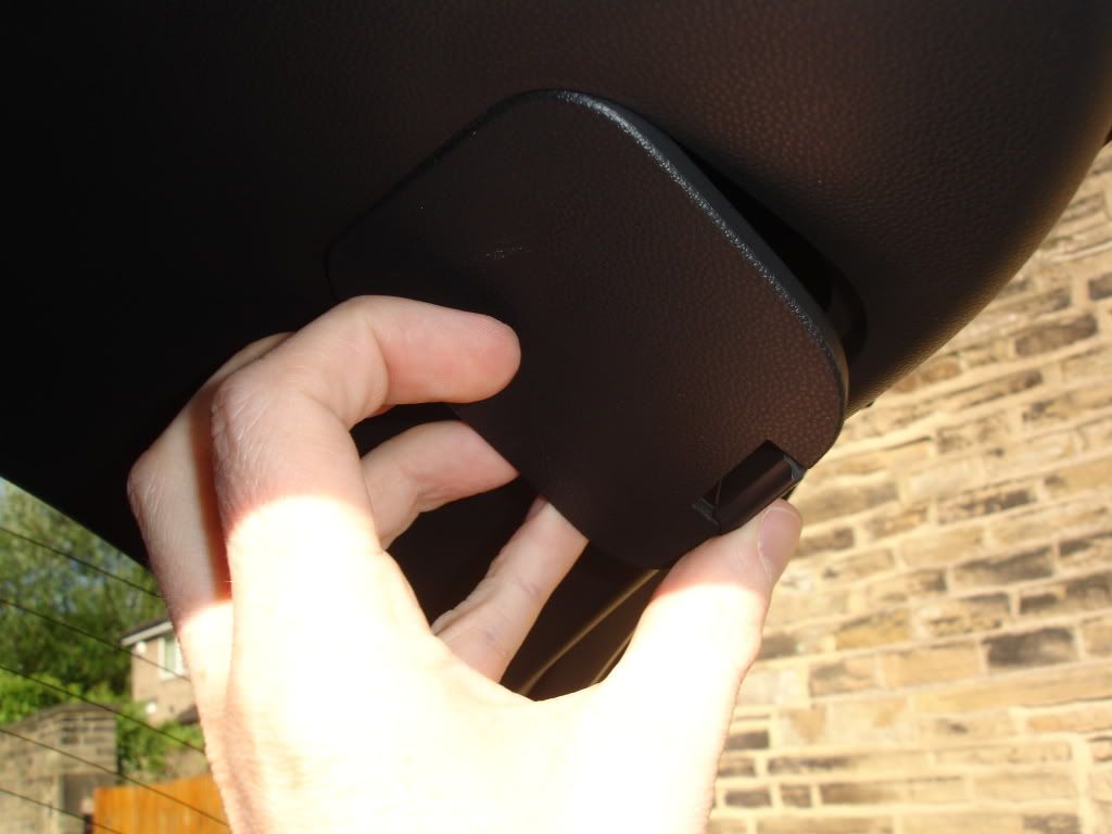

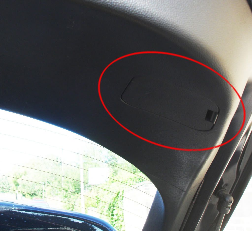

(1) Open the boot and locate the access hatch on the right hand side

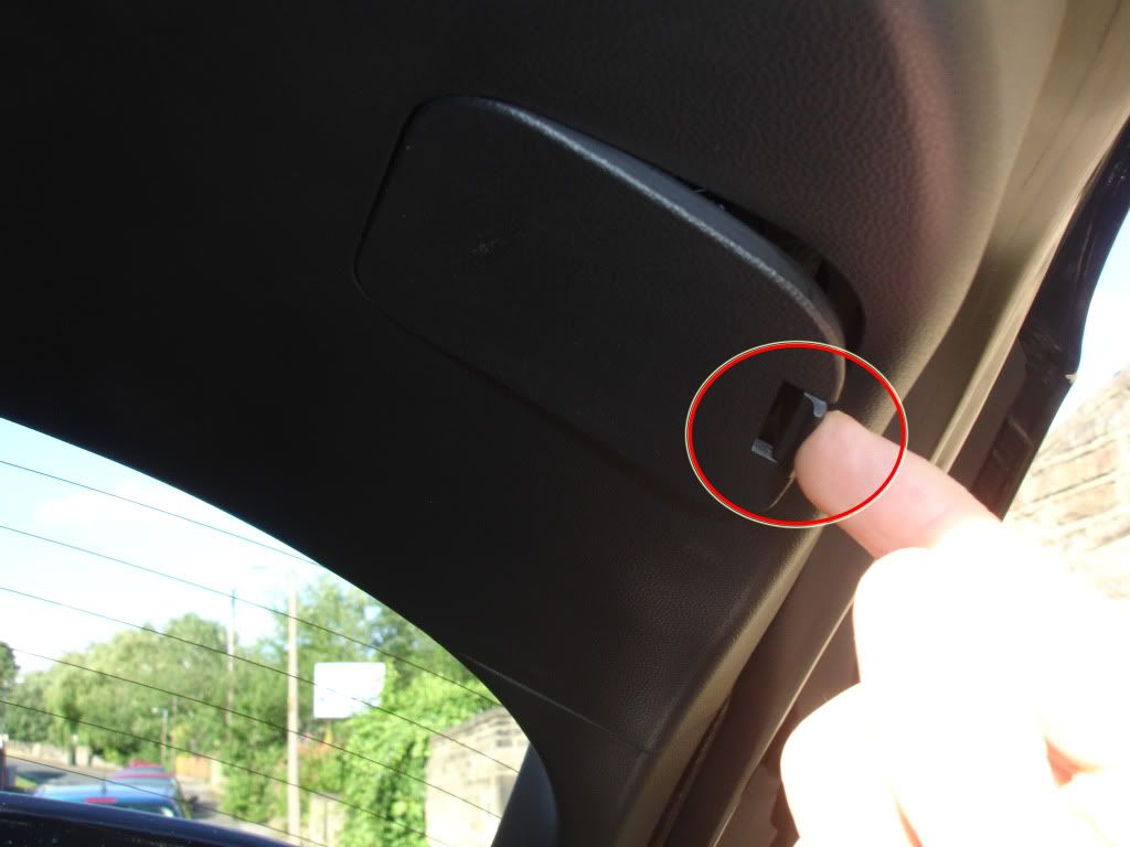

(2) use your finger to open the hatch

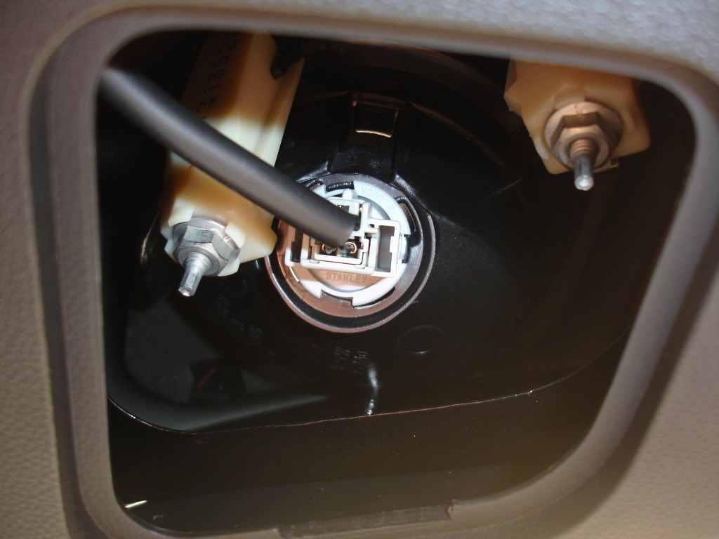

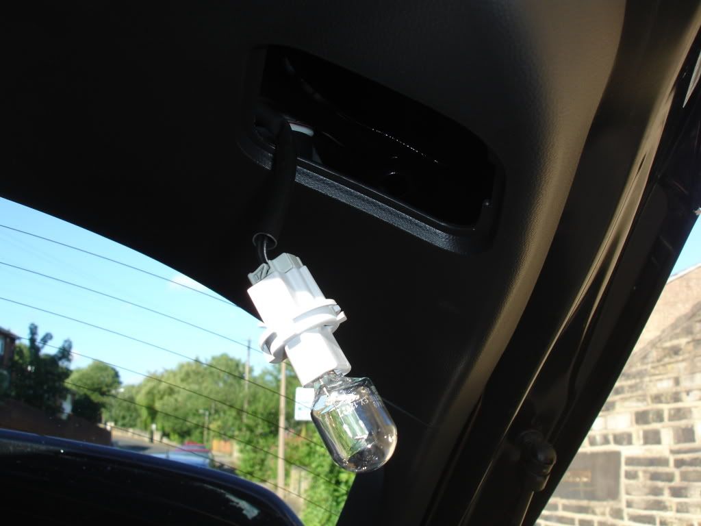

(3) You should now see the back side of the lens

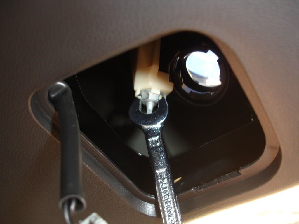

Note that there are TWO bolts

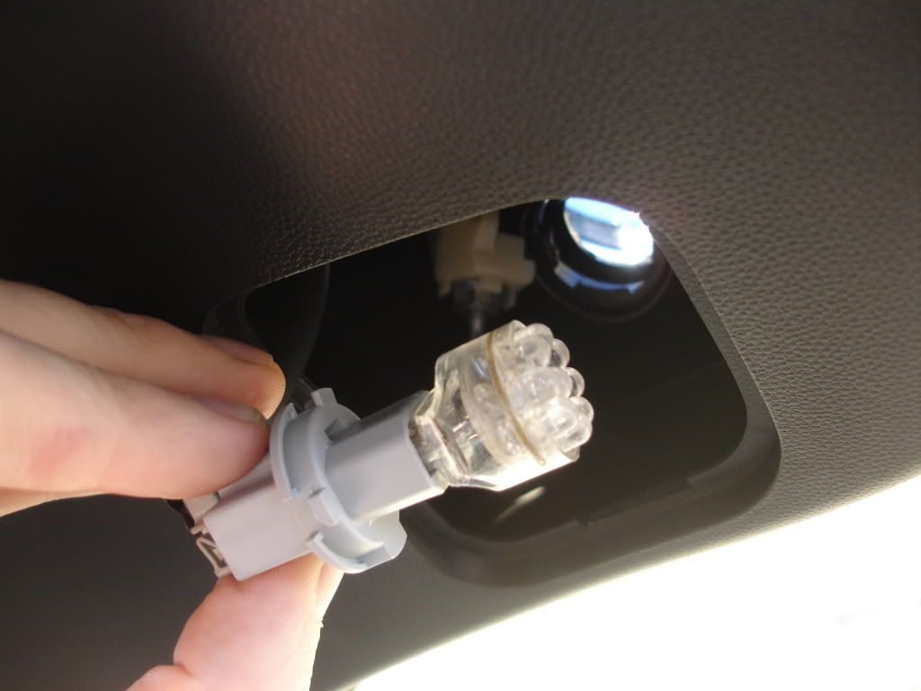

(4) Remove the bulb and bulb assembly by twisting anti-clockwise. The bulb should now be out of the way

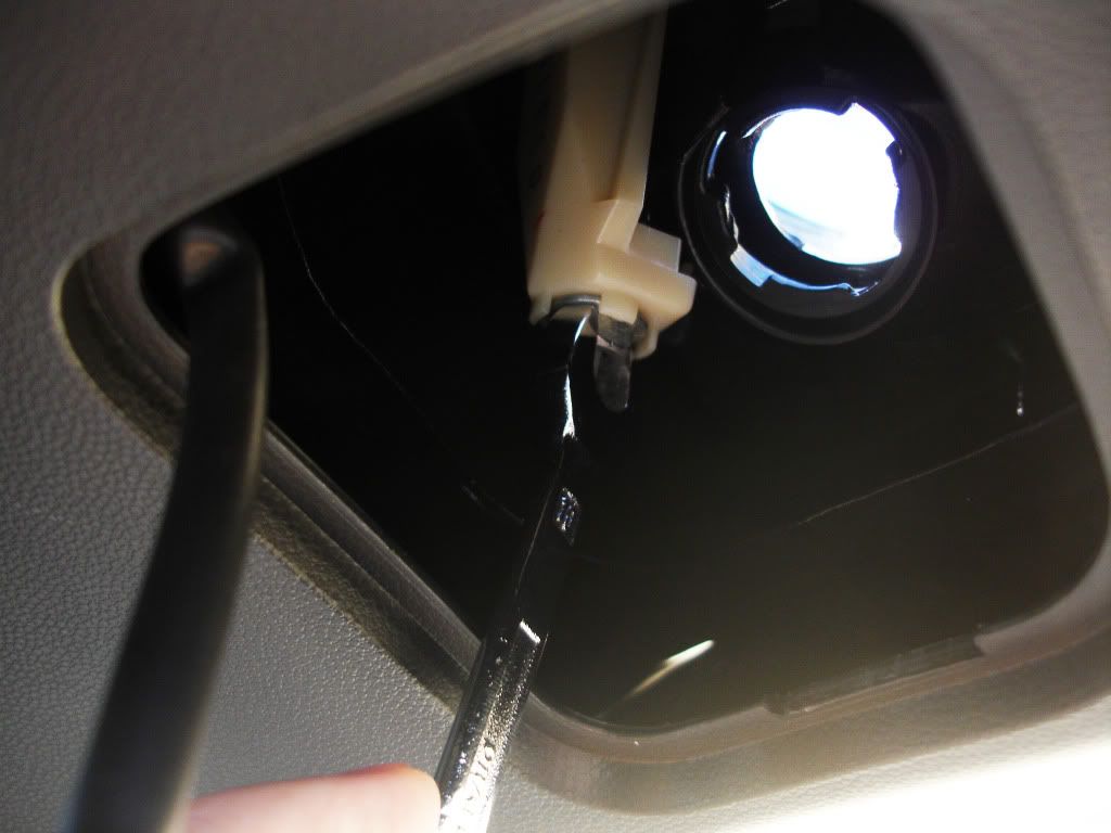

(5) Using the spanner loosen the two bolts and remove by hand or continue using the spanner

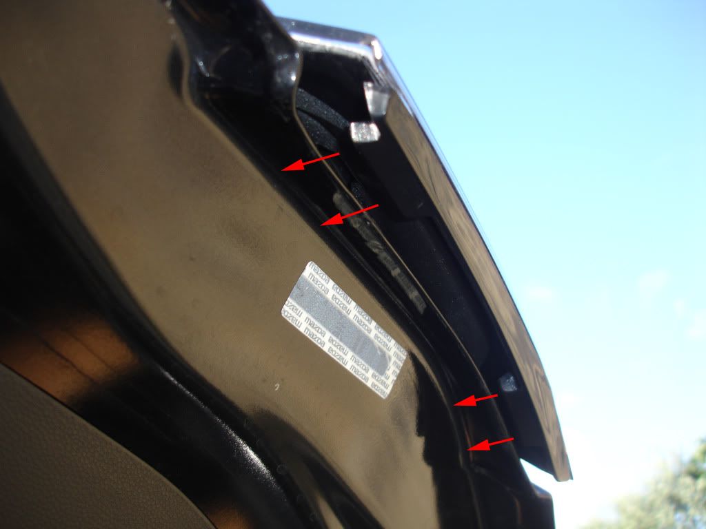

(6) Once you have removed BOTH bolts and the plastic retainers the whole lens should now be loose. You may need to press upwards and outwards from within the hatch to loosen the lens.

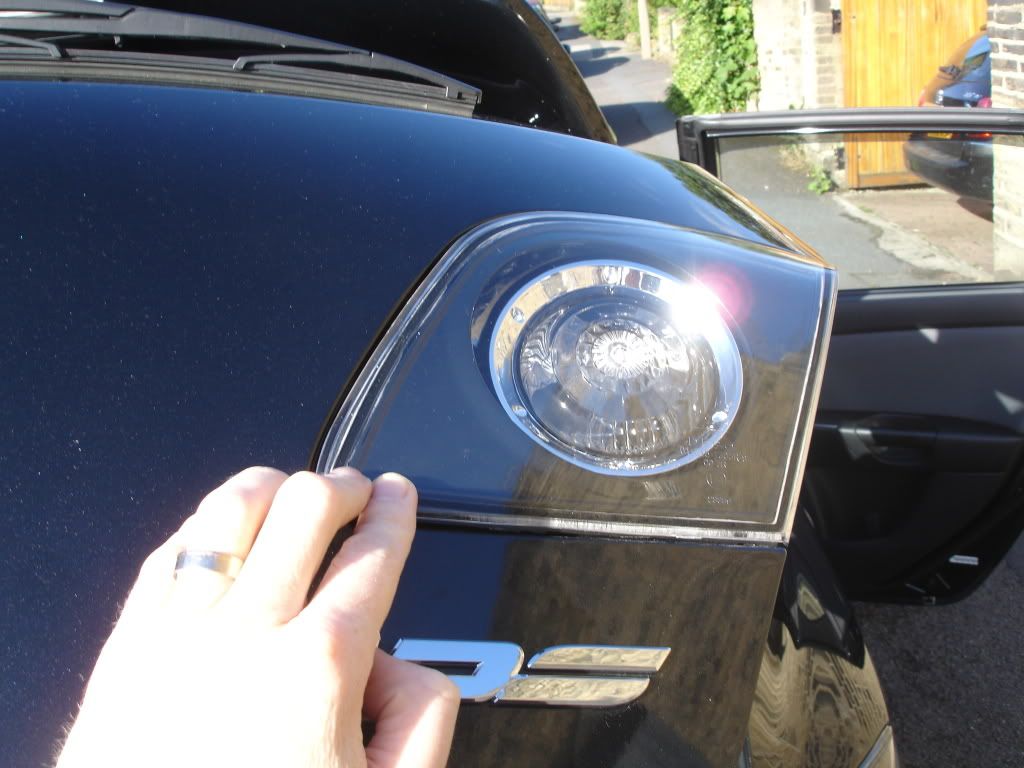

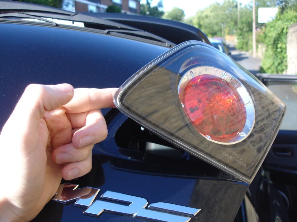

(7) Remove the lens by lifting from the left hand side. The lens is clipped over the boot at the right hand side

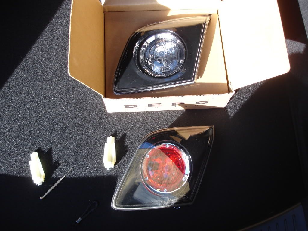

(8) Ta da! You should now have completely removed the RED lens.
(9) Loosen, but do not remove the two bolts on the new CLEAR lens. Start by clipping the CLEAR lens onto the boot on the right hand side. There are two tabs that hook over the metal
(10) Once you have clipped it over push down and the lens should loosely clip into place
(11) Using the spanner tighten up the two bolts to secure the lens in place
(12) Replace the bulb with your new RED bulb (led or otherwise)
