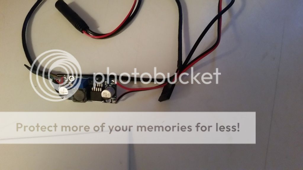

1.   Step-up converter
I used a AC/DC Multi Voltage Power Supply Adapter to supply 5 volts to the input side of the Step-up Voltage Converter, checked the output (with the multi-meter) and adjusted to 12v as required. Once this has been done, set aside.

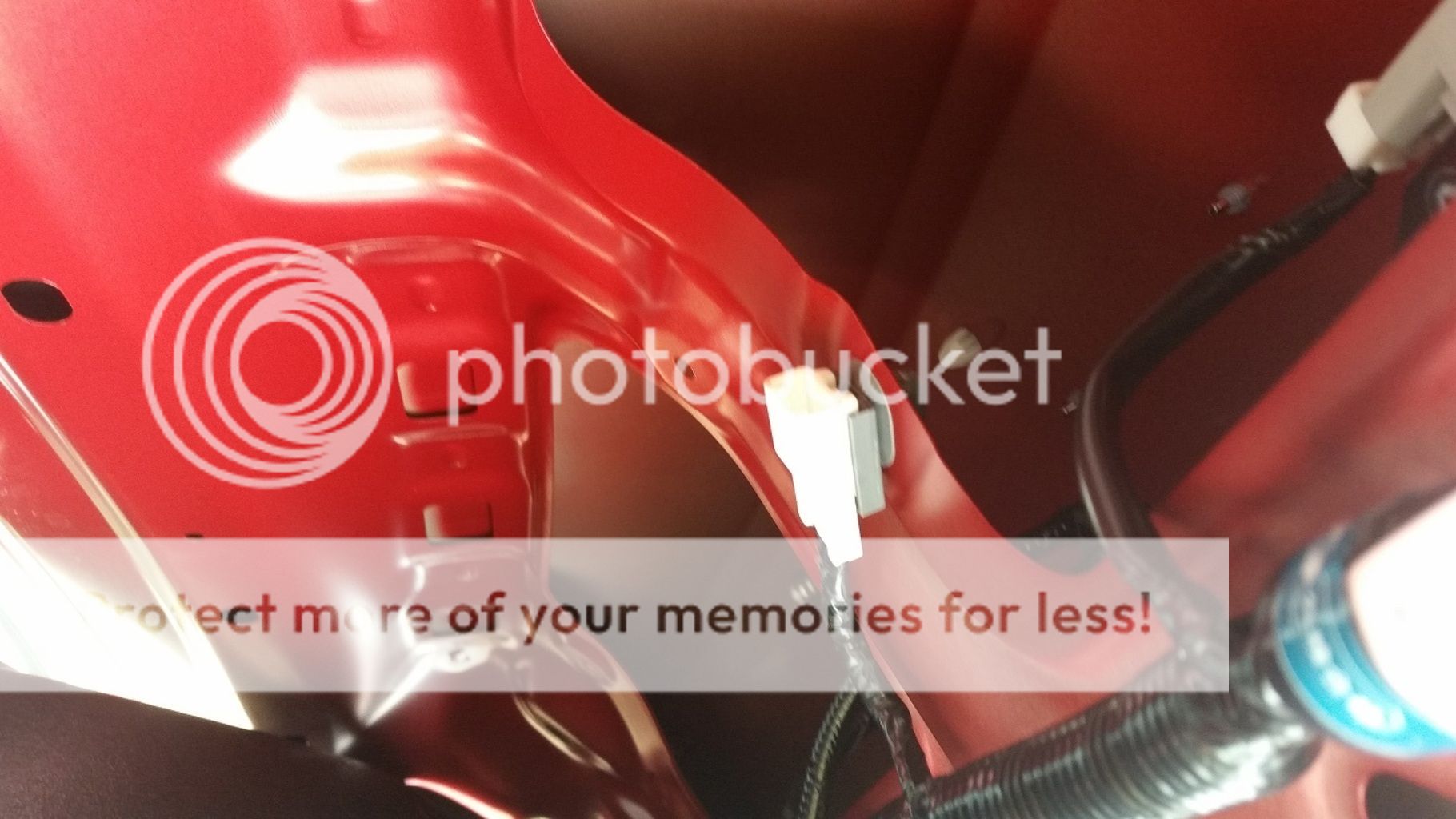

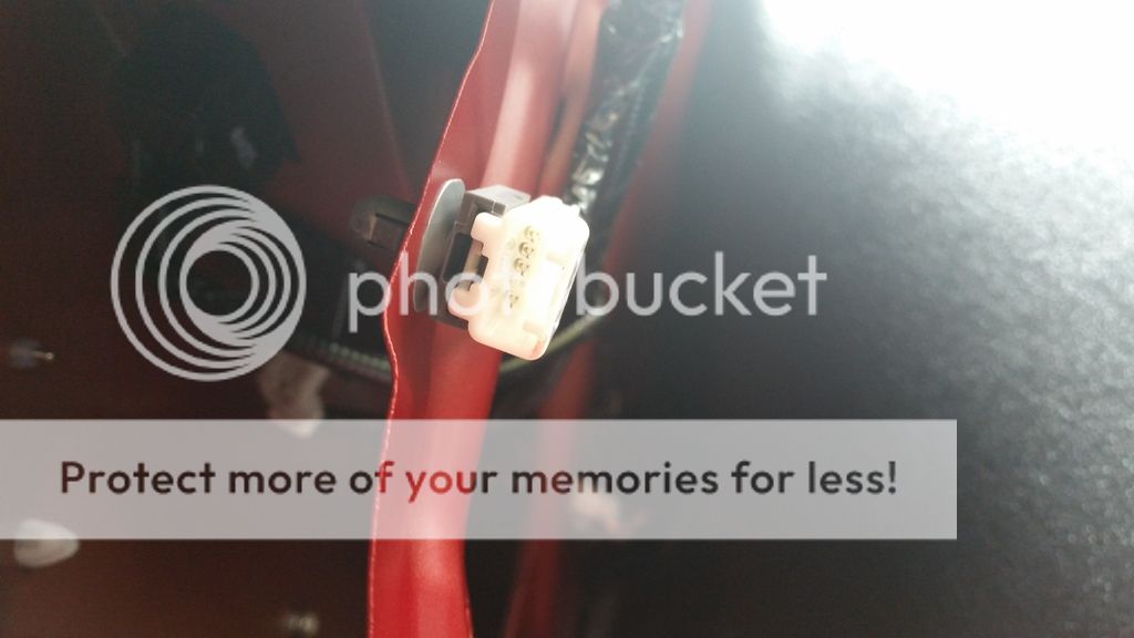

2.   Internal (pre-installed) connector
This is a 5 pin 0.1” socket (on mine), where only 4 pins are present, pin 4 is missing.  (The 5Pin Female 0.1" USB header PCB motherboard cable above is perfect)
Pins are, from top to bottom,
1 ground (cable screen)
2 ground (black)
3 Video in from Camera (green)
4 Missing pin (white)
5 +5v (red)

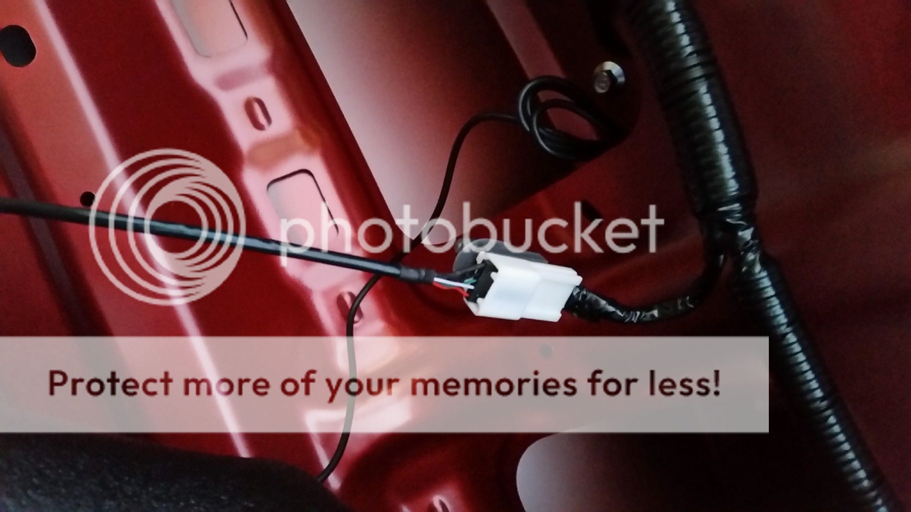

Take the USB PCB motherboard cable and trim back to the required length. Discard moulded USB plug (not required).
Strip back cable, to expose the cable screen, black, green, white and red internal wires.
Strip, wrap and solder the cable screen and internal black wire together.
Strip red wire
Strip green wire
The white wire is not used.
Solder the joined cable screen and black wires to the ‘In -‘ terminal on the step-up converter, solder the red wire to the ‘in +’ terminal on the step-up converter (see link from ebay above). Set aside.

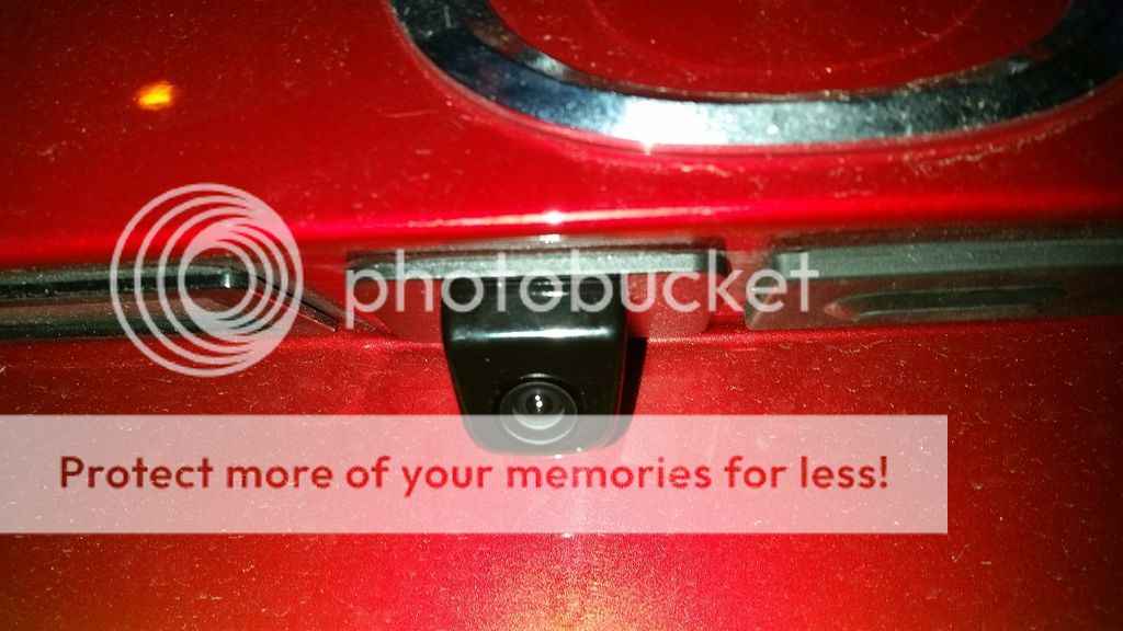

4.   Drill a hole in blanking plate (or spare plate if you purchased one) and mount camera to the plate.

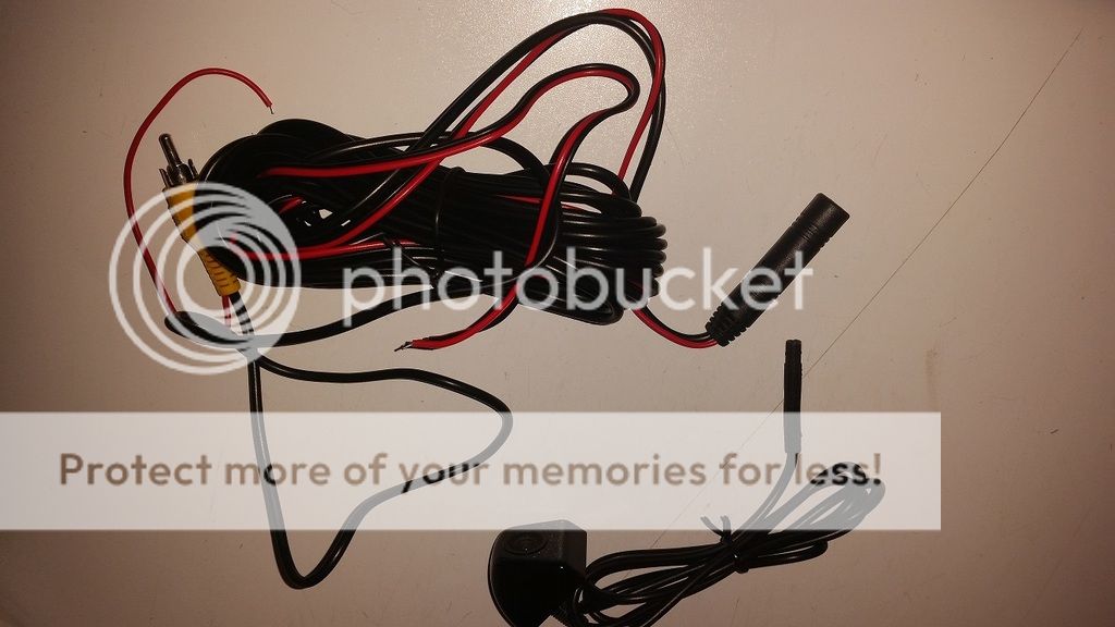

5.   Shorten the second lead supplied with the camera, removing the phono plug and shortening the power leads.
6.   Strip the red and black power leads for the camera and solder to the step-up converter, black to the ‘Out –‘ terminal and red to the ‘out +’ terminal.
7.   Strip back the video cable, you are only interested in the internal yellow wire, make sure the other cables are insulated and not able to short circuit. Connect the yellow wire from the video cable to the green wire from the PCB motherboard cable from (2) above.

9.   Assemble – mount blanking plate now holding camera back into boot lid. Plug PCB motherboard cable from 2 above into pre-installed connector. Tidy cables. I mounted the step-up converted in a small plastic tube and cabled tied everything together to the pre-existing wiring loom attached to the boot lid.

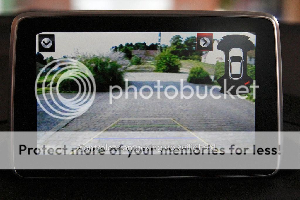

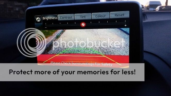

10.   Test! – power the car (2 presses of the power button, no need to start the engine), wait until car is powered and the disclaimer message has  been removed from the screen, press and hold return+nav+mute for about 10 seconds. This forces the infotainment centre to reboot, and it should pick up the camera. After the infotainment centre has rebooted and the disclaimer message has disappeared from the screen, you can put the car in reverse, if everything is ok then you should get the video image on your screen.
I did not take a photo of the overlay in mine, but this is exactly what I get:
